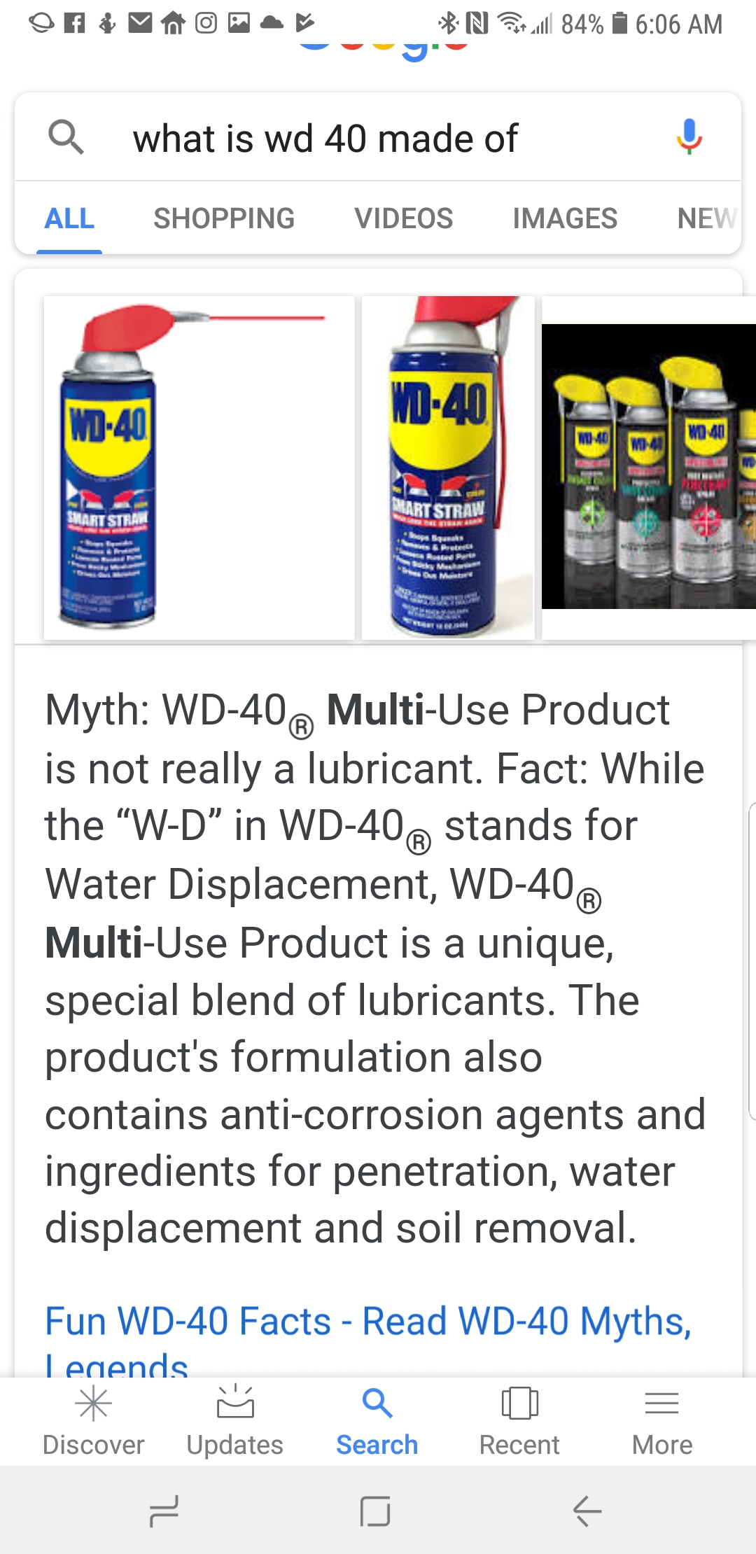

Mark Saiger
Image result for what is wd 40 made of
View all
Myth: WD-40® Multi-Use Product is not really a lubricant. Fact: While the “W-D” in WD-40® stands for Water Displacement, WD-40® Multi-Use Product is a unique, special blend of lubricants. The product's formulation also contains anti-corrosion agents and ingredients for penetration, water displacement and soil removal.

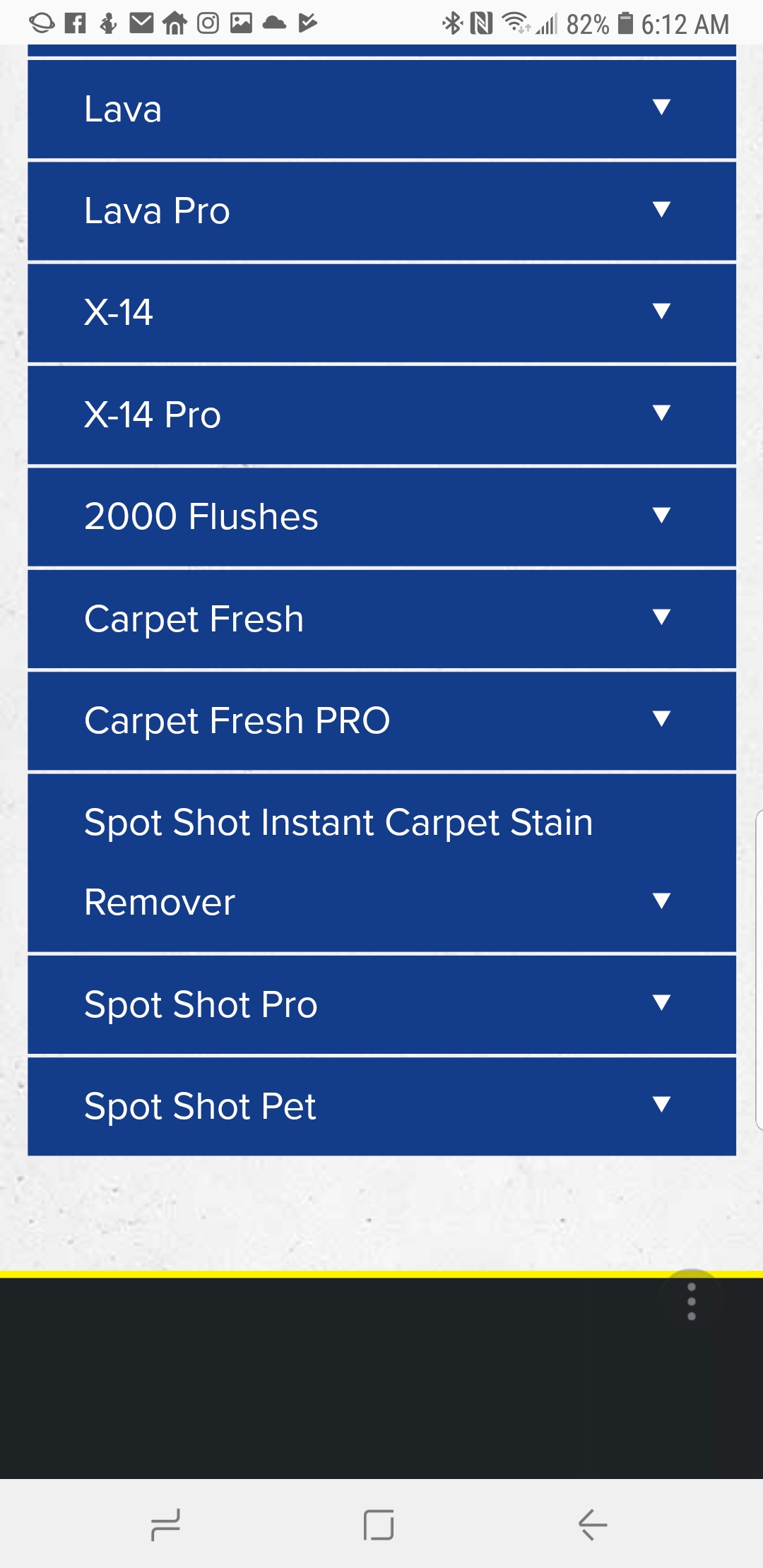

Mark Saiger
Look at who is also involved in the carpet cleaning industry.
This is screen shot from the WD 40 SDS section of their website
