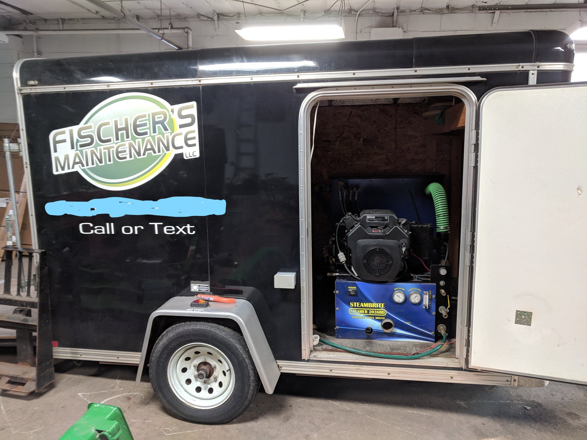

Here are some pics... the only pics other than one showing 41 hours on it.
C1A6620A-25DB-41C0-97E2-B30074384320.jpeg 38413750-2A2D-4606-AB04-A2AB67FD810B.jpeg A9FF0468-DF6D-420F-A3C9-615515559D3B.jpeg

The TM only is 3k, I can get the whole trailer with 200 feet of 2 inch for 5.5k.
I've never run an EZ so I can't say for sure if its junk or not. I'm not biased against the manufacturer like some though so I'd consider it. Plenty of folks love their EZs
At 3k and low hours I'd probably chance it after making sure there were no signs of freeze damage/nerf goop/other issues.
Looks like a decent unit

I don’t know him, he’s just known in some circles and doesn’t seem to be a chump. I spoke with him over the phone and he didn’t pull a Guerkink or anything. Definitely didn’t try to sell me. Said the trailer has been stashed in one of his two shops the entire 2-3 years he’s owned it.
He’s 9 hours away.
28,277
As long as it's running and like Fred said, there's no freeze damage, it sounds like a bargain. Hook it up and run it, check for leaks, heat and vacuum.
