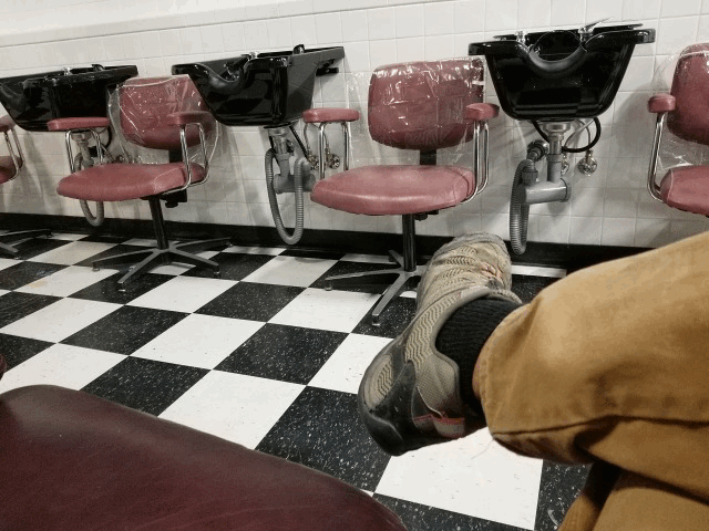

Yippee!
117,344
10,234
I’m not real sure what you’re yippeeing? Looks like you’ve been in my shop
and if you have, well.
Sucks to be you!

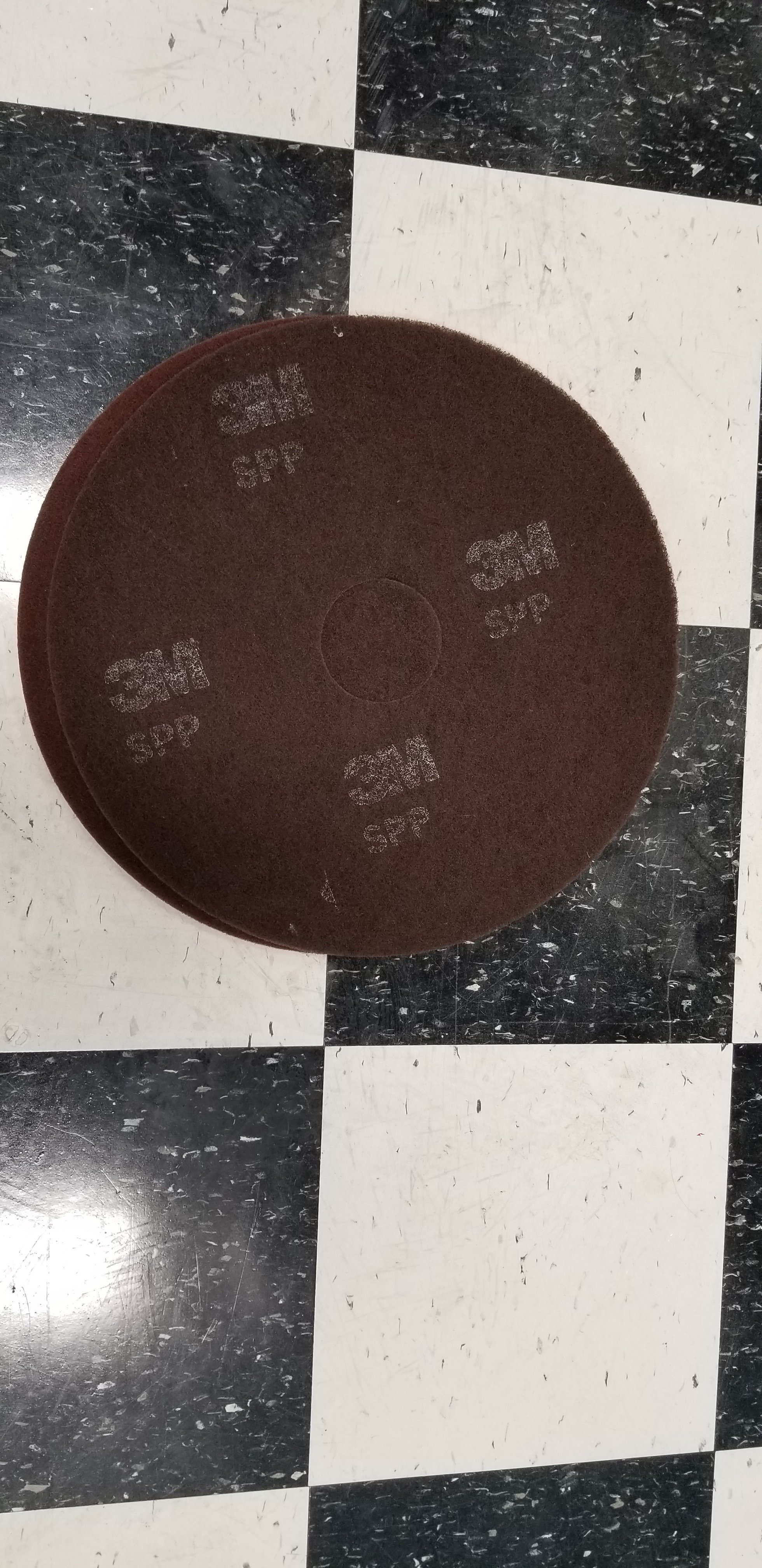

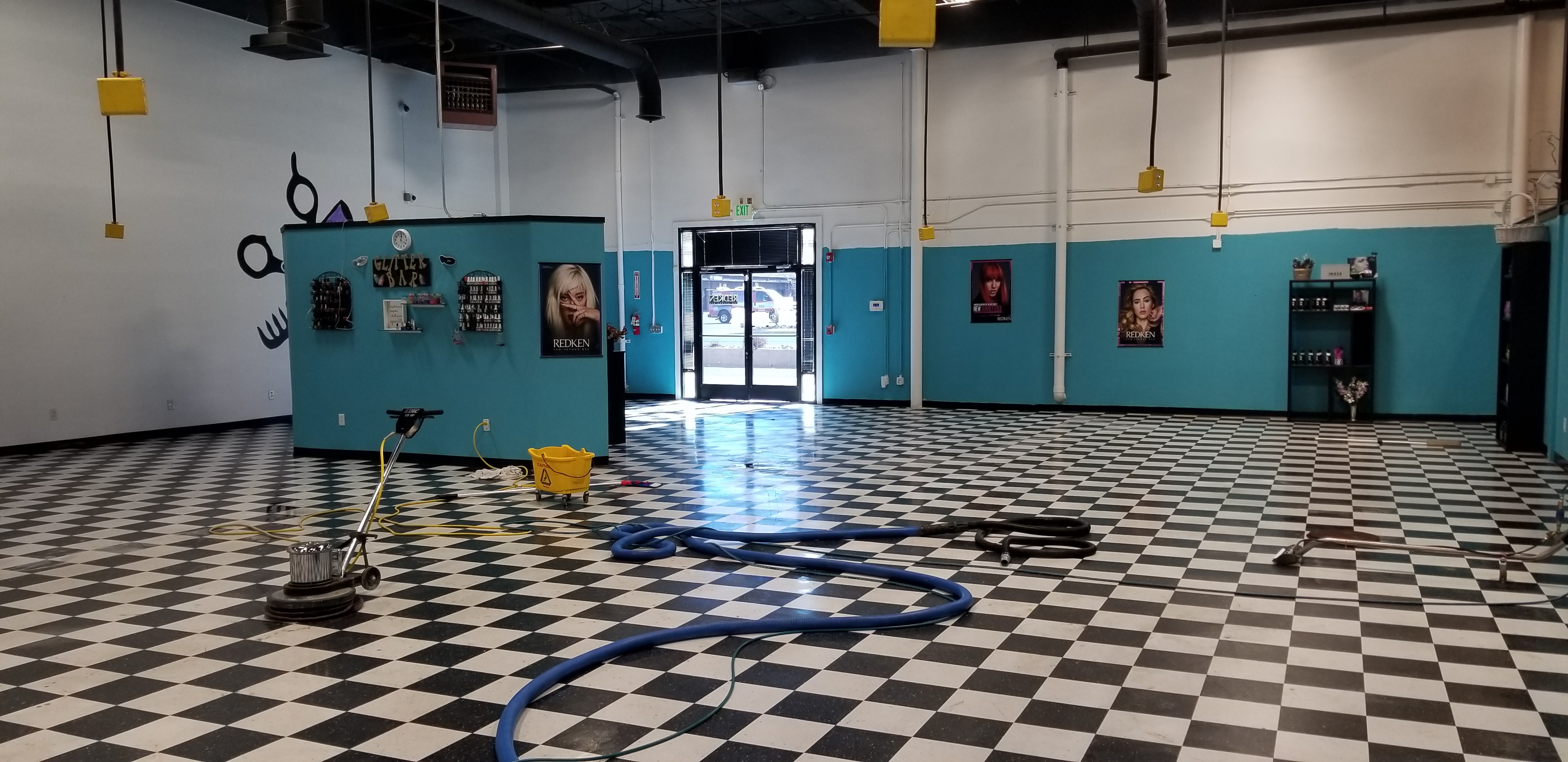

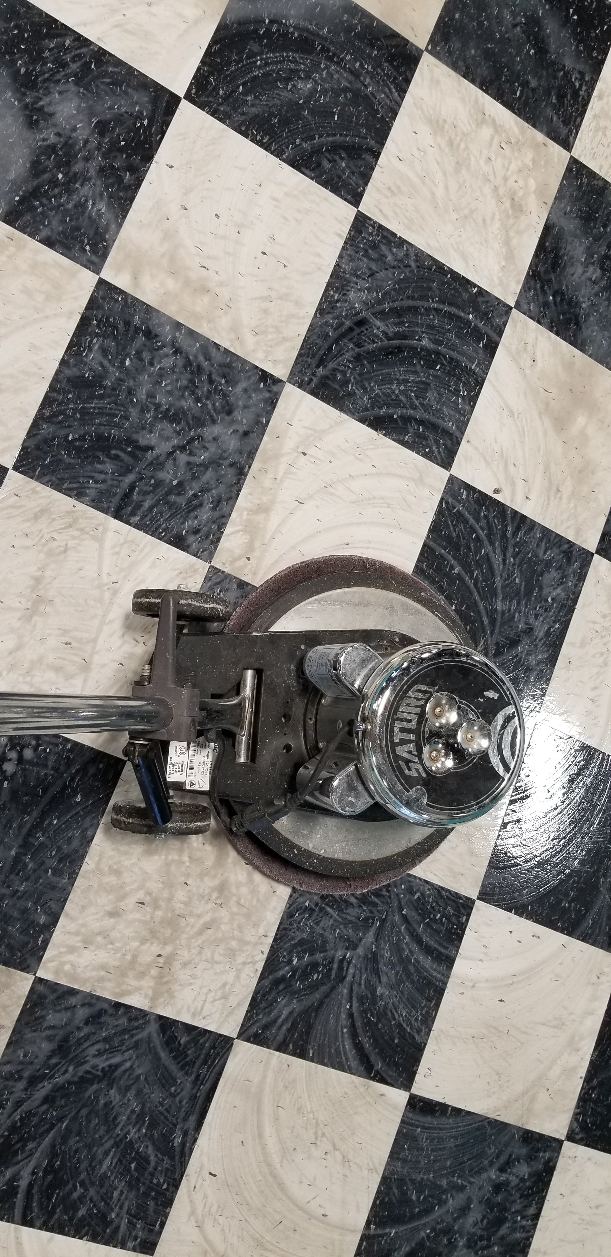

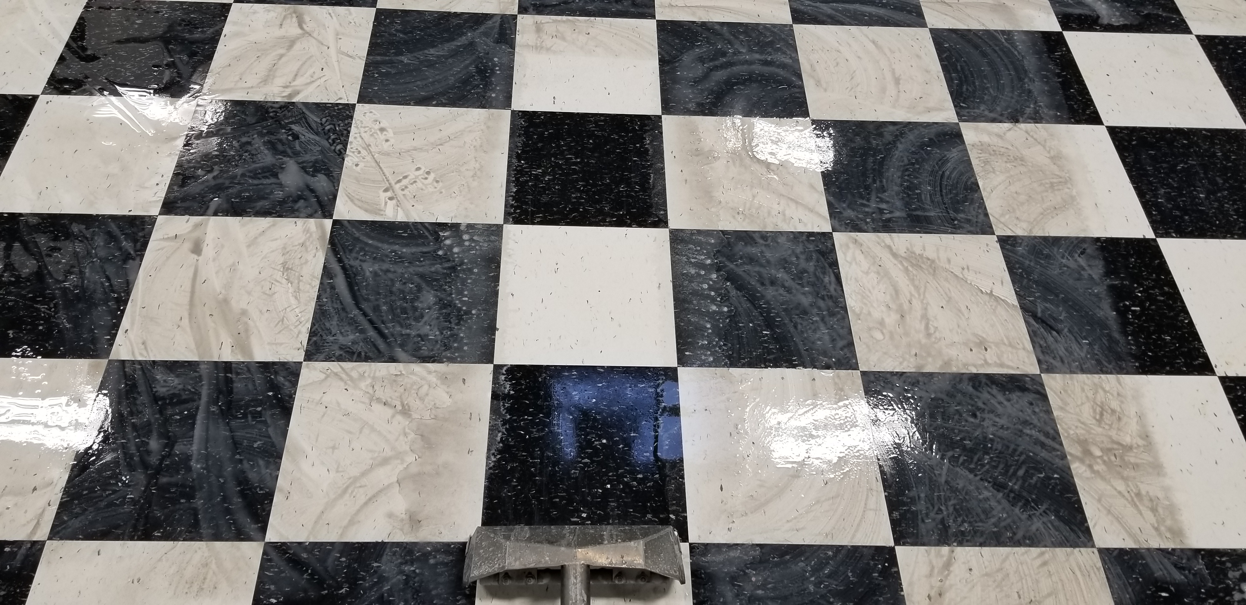

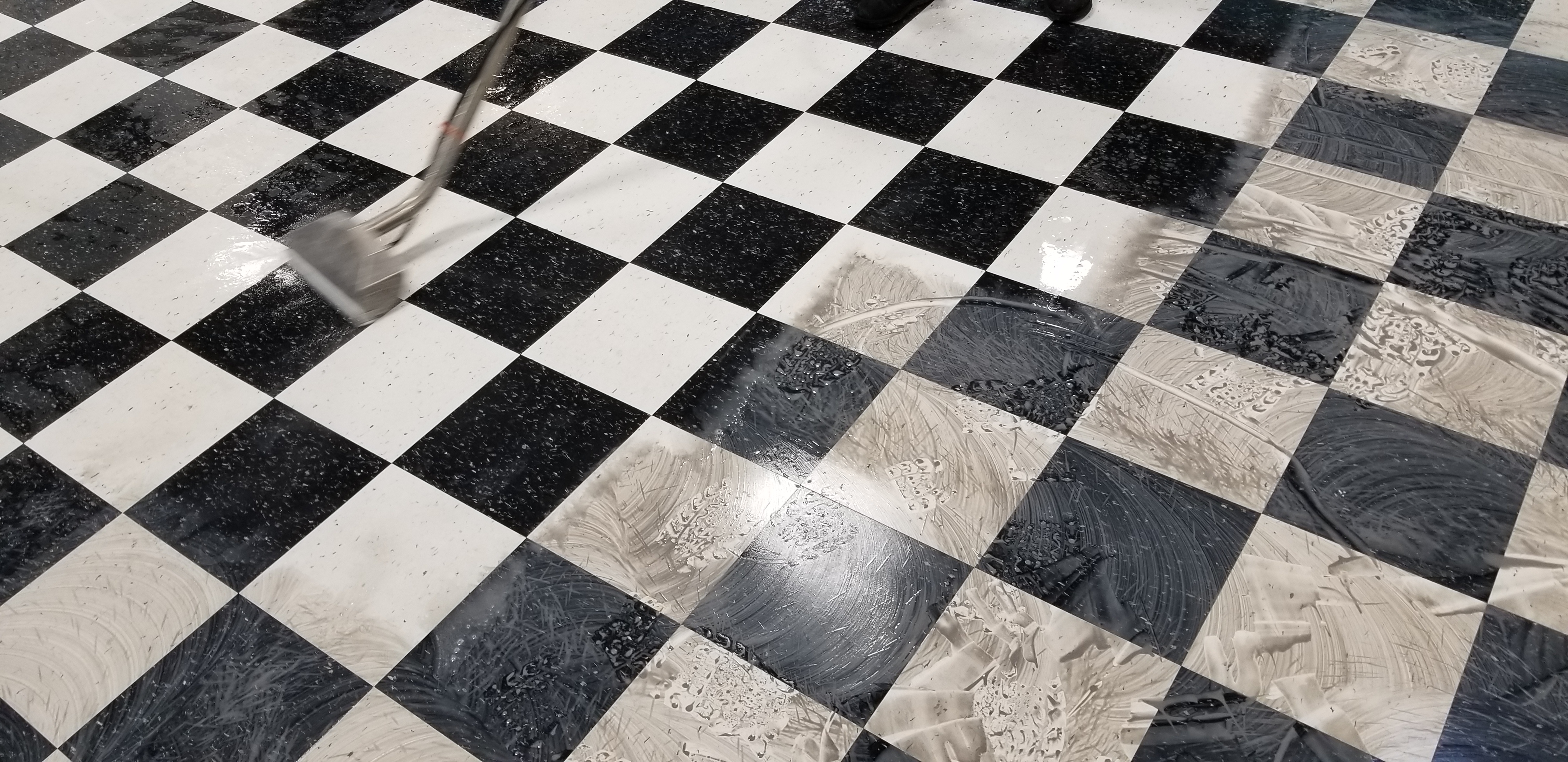

SPPs work great at taking the dirt, stains and heavy wax build up off but the needed amount of healing the 175 has me sore as F today.

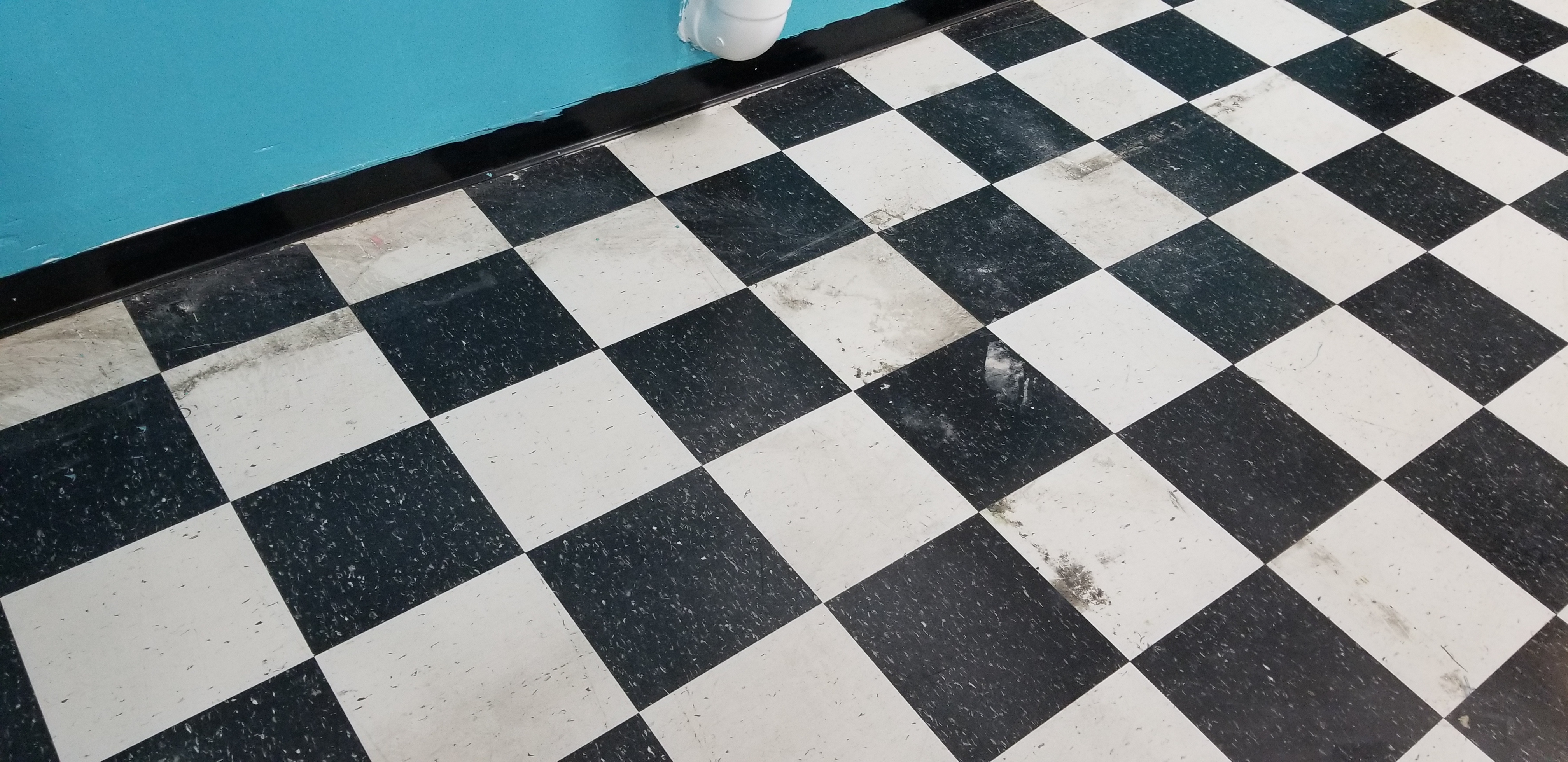

Some Fidiot was waxing the floor with with a sting mop and the wax in a bucket so most of the edges, corner and nooks and crannies have insane build up of dirty wax. The owner has the students do the maintenance and does not supply the proper equipment (no vacuums on site...
I went way further than our original agreement on how deep I would scrub but in the end, I'm getting $3600 worth of trade wiht them supplying all the chems, pads and wax.

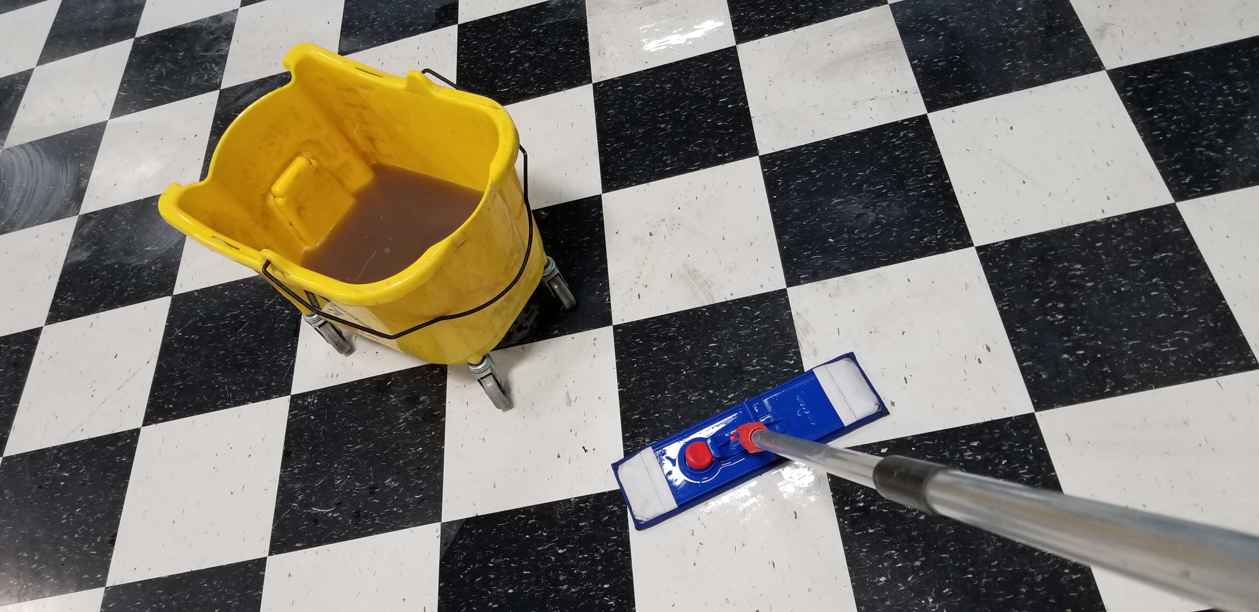

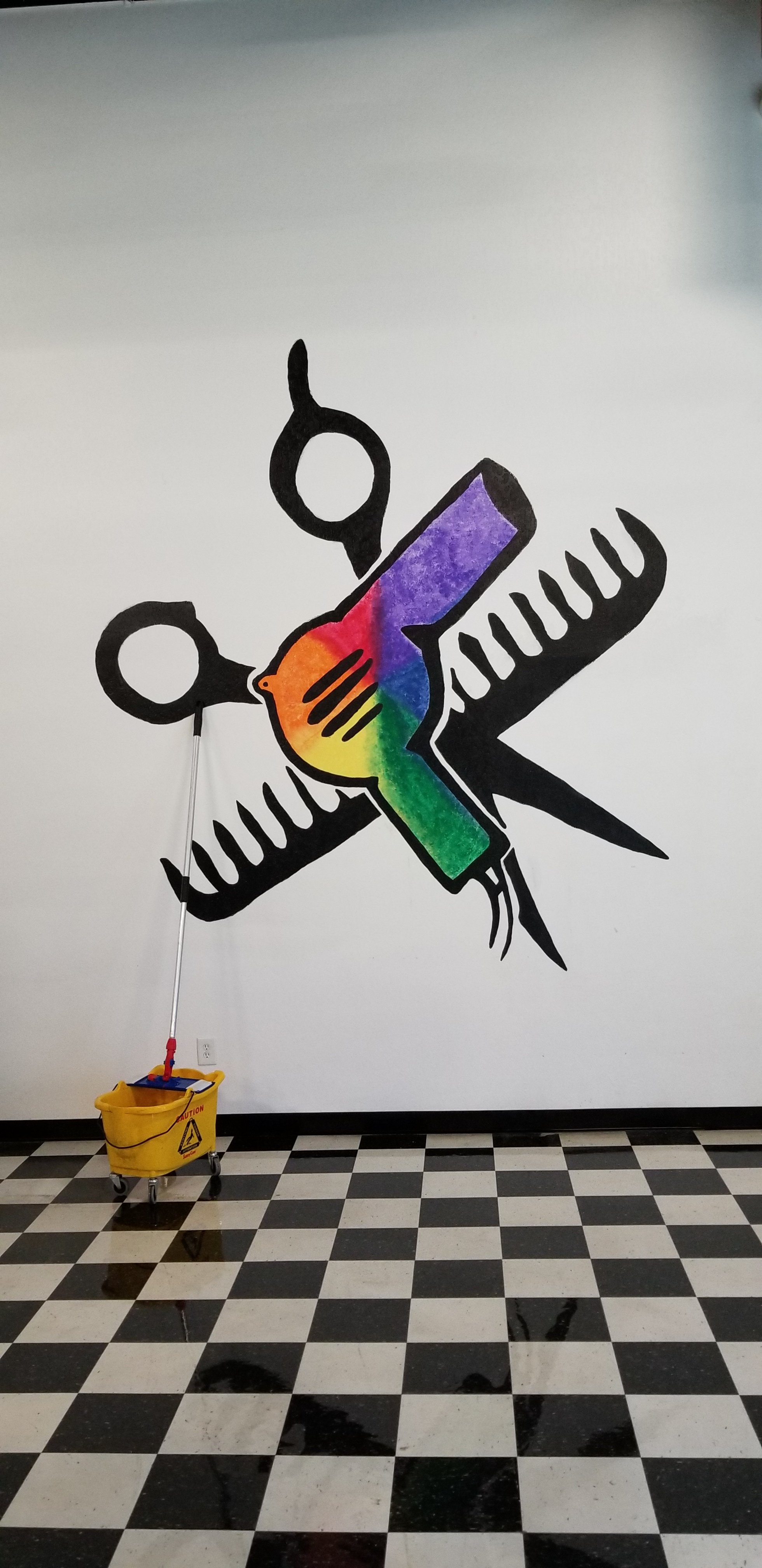

Today is wax day....wippee X's 2.
24,146

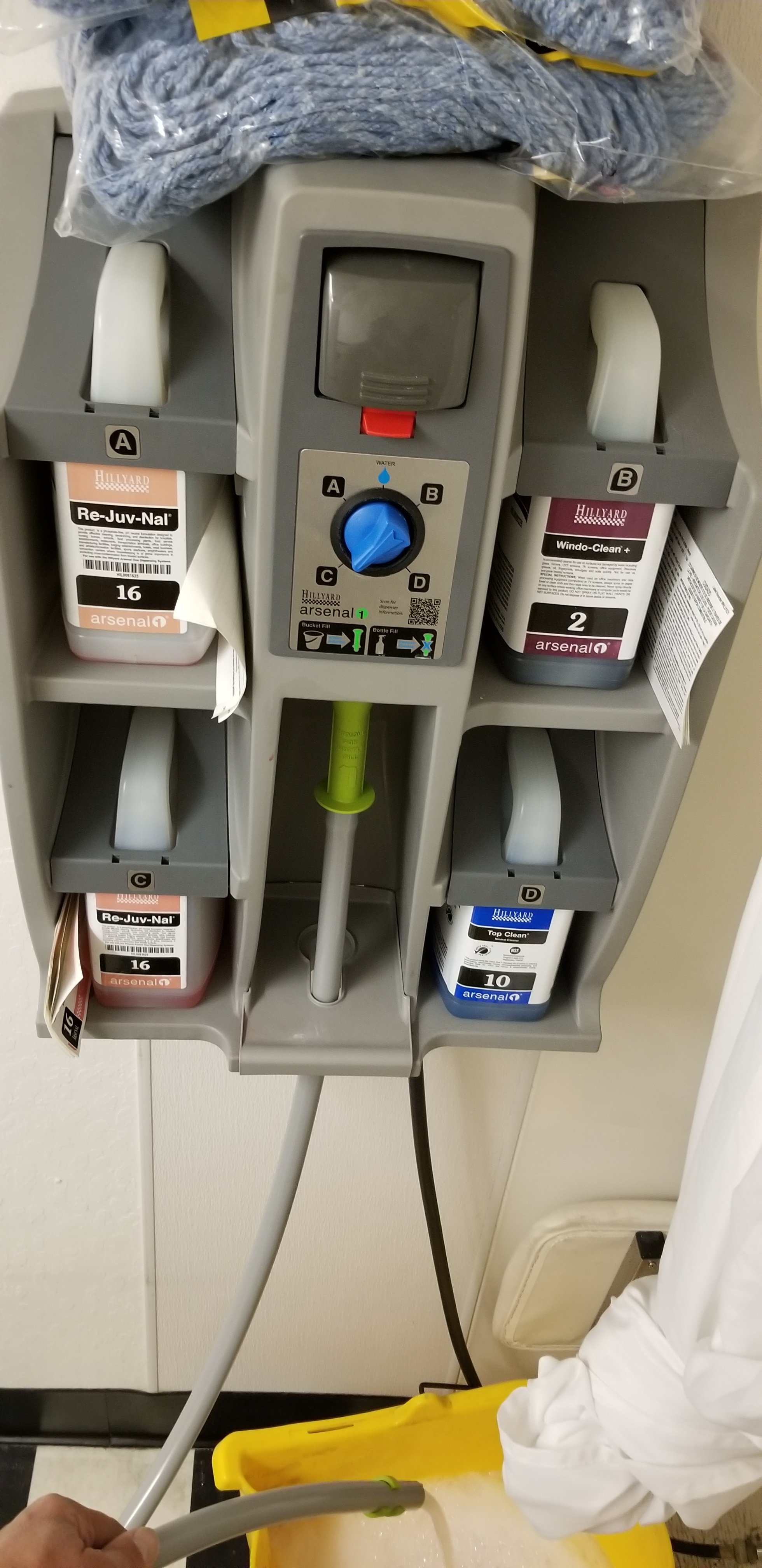

I use a similar system but I made the wax reservoir myself out of a 2-liter Mt Dew bottle and surgical tubing. Works really well.
24,146
I'll post a pic for you later. The mop has a holder for the wax cartridges. I didn't want to buy their proprietary wax jugs so I made my own.

Well yeah, stock. I would too. You retro fit it with 25 or 50 ft. 1 1/2 hose and a 28” Kiavac floor tool. Put a tank on that 175, and off you go. Flat finish mop, but not microfiber. Rubbermaid flat finish bucket. And off you go.
10,234

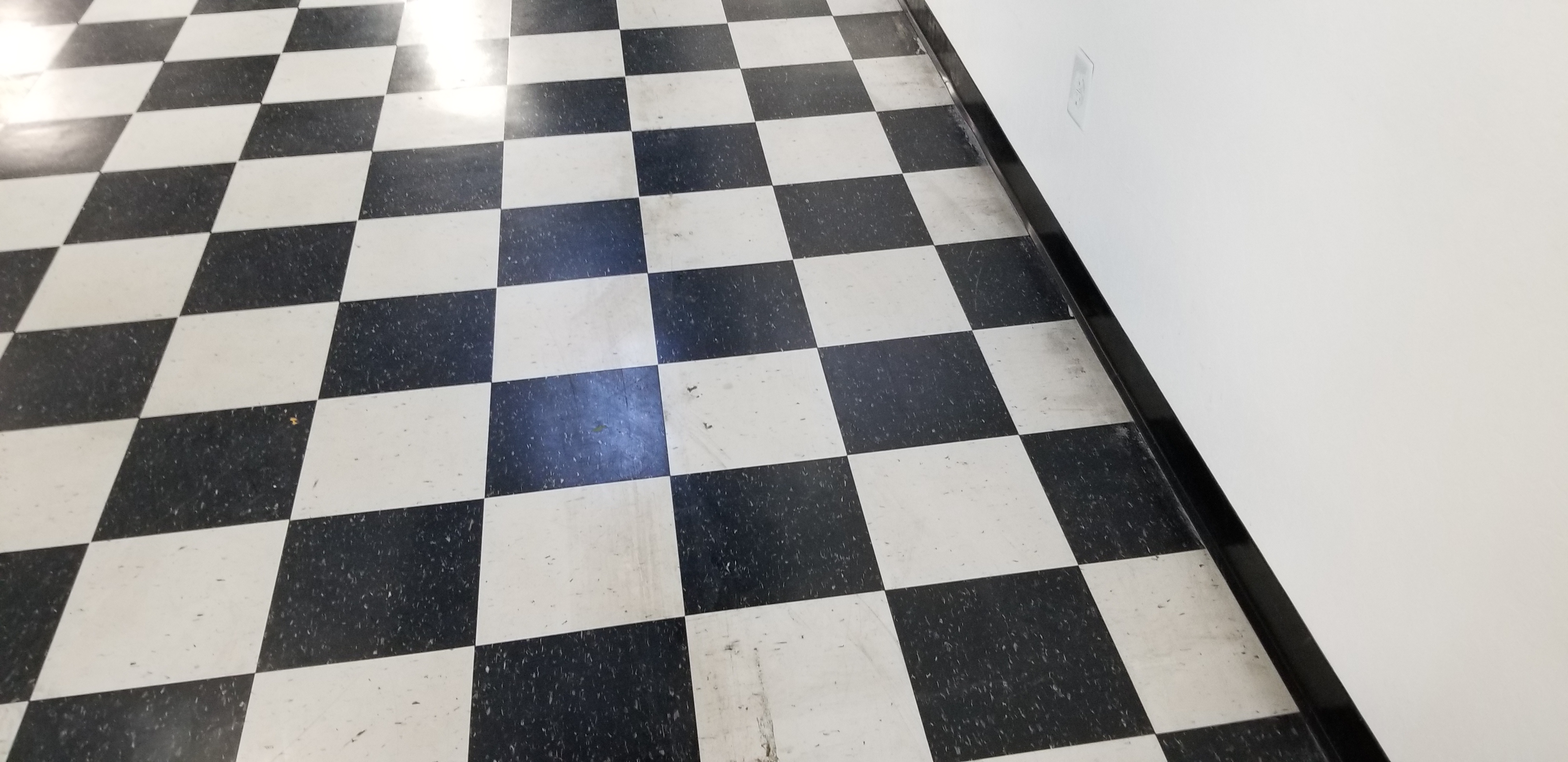

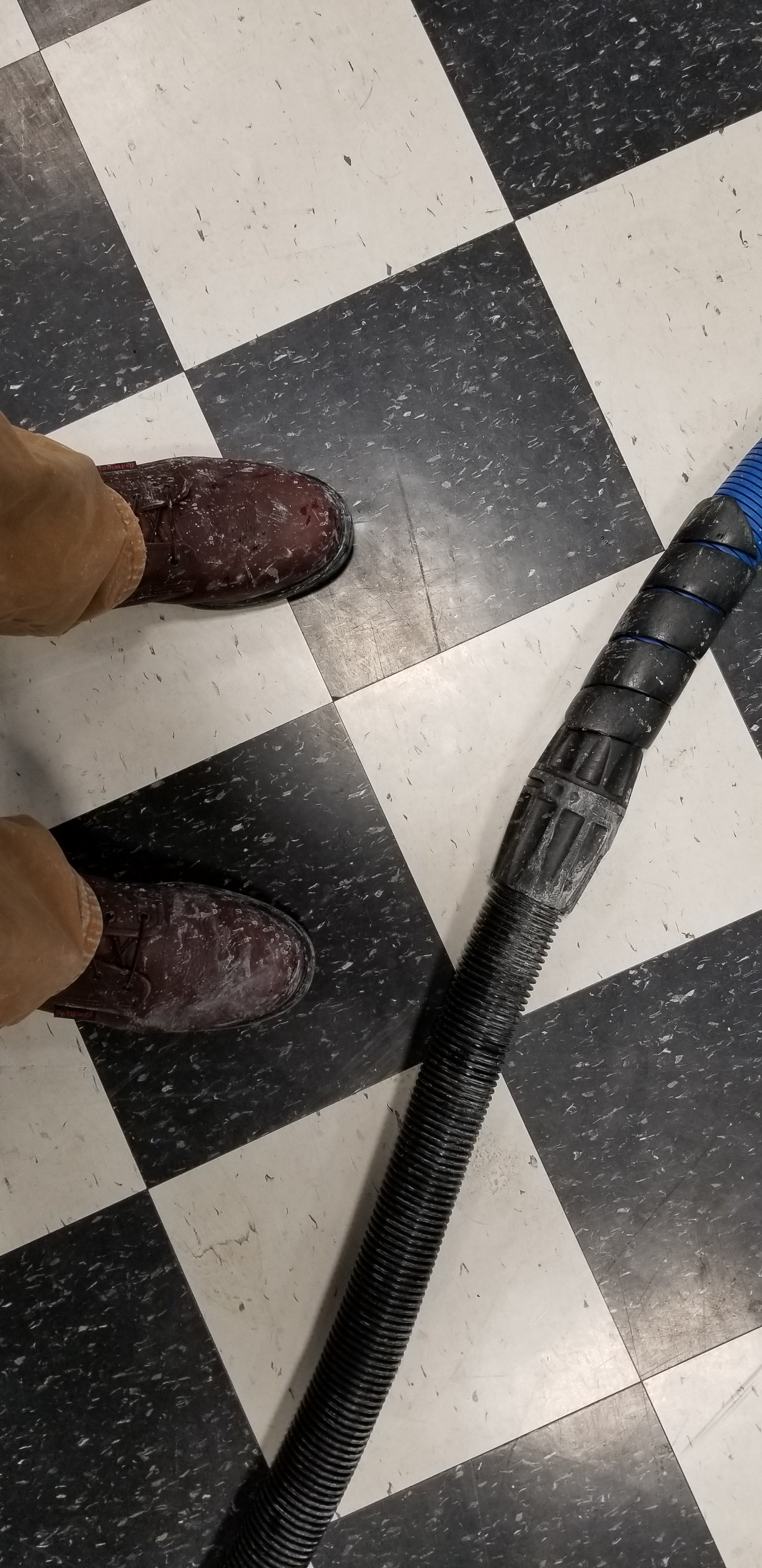

Lollllll., get your ass up from there. Put a fan on that, not a blower, set it away from the floor!! Bahaaaaa. So, now you are semi-retired!!!:headscratch::biggrin::biggrin:
10,234
And of course your floor is black and white which sucks itself!! Yes I’ve done hundreds of em.
