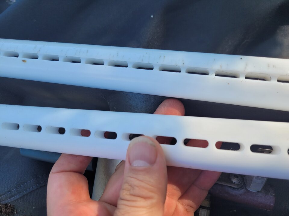

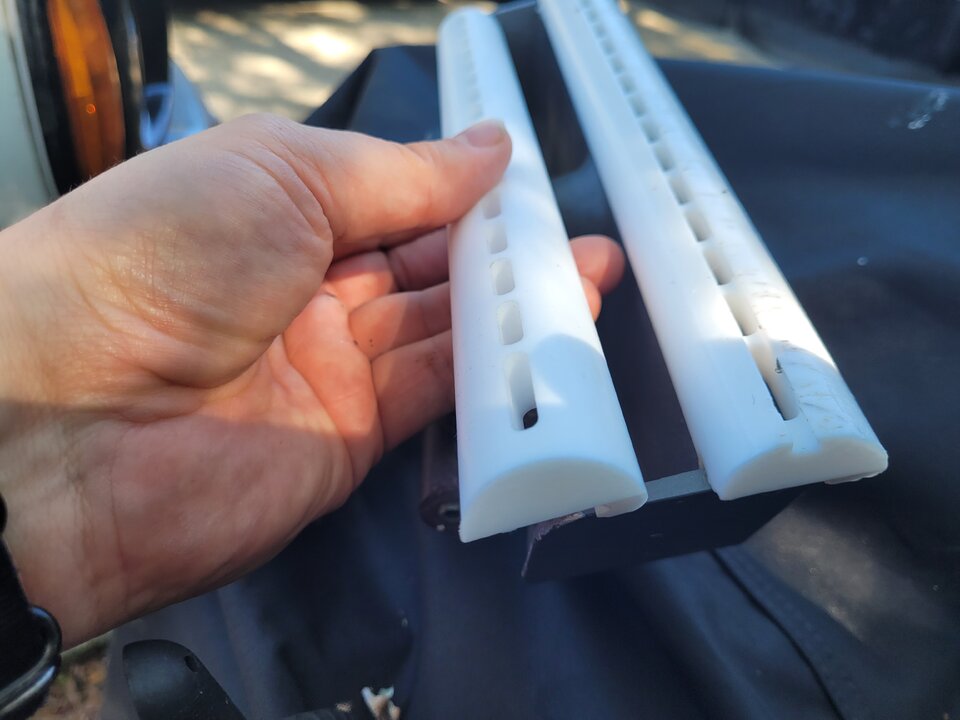

No idea what groove your referring to on a Hybrid
Groove, no groove. The groove causes the glide to grab the carpet. Kinda defeats the purpose of having a glide :headscratch:
116,518
View attachment 130916 View attachment 130917
The groove is to prevent lines from the bridges and to create airflow at the end for better edge cleaning and reduce lockdown.
Many cleaners like the little bit of bite that the groove creates. Our grove is less grabby than others..
Try a glideless wand like a Prochem Ti or Quad sometimes, that tiny bit of grab is nothing...
