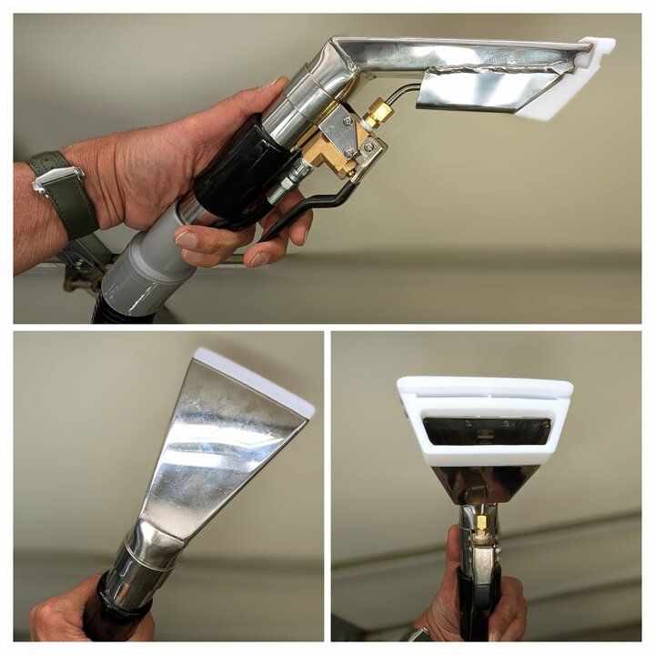

New upholstery tool devlopment is coming along..

The tool is really coming along impressively
Two units will be in Indianapolis to play with Screenshot_20250318-213321.png

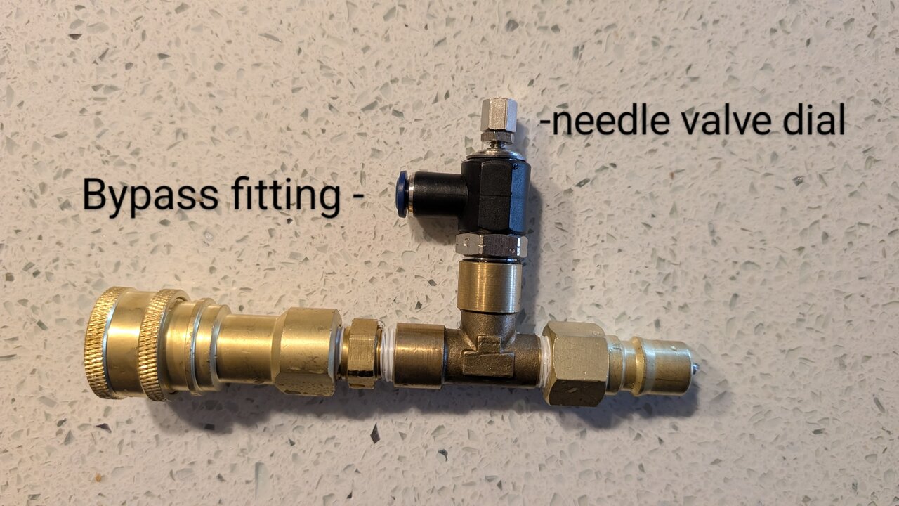

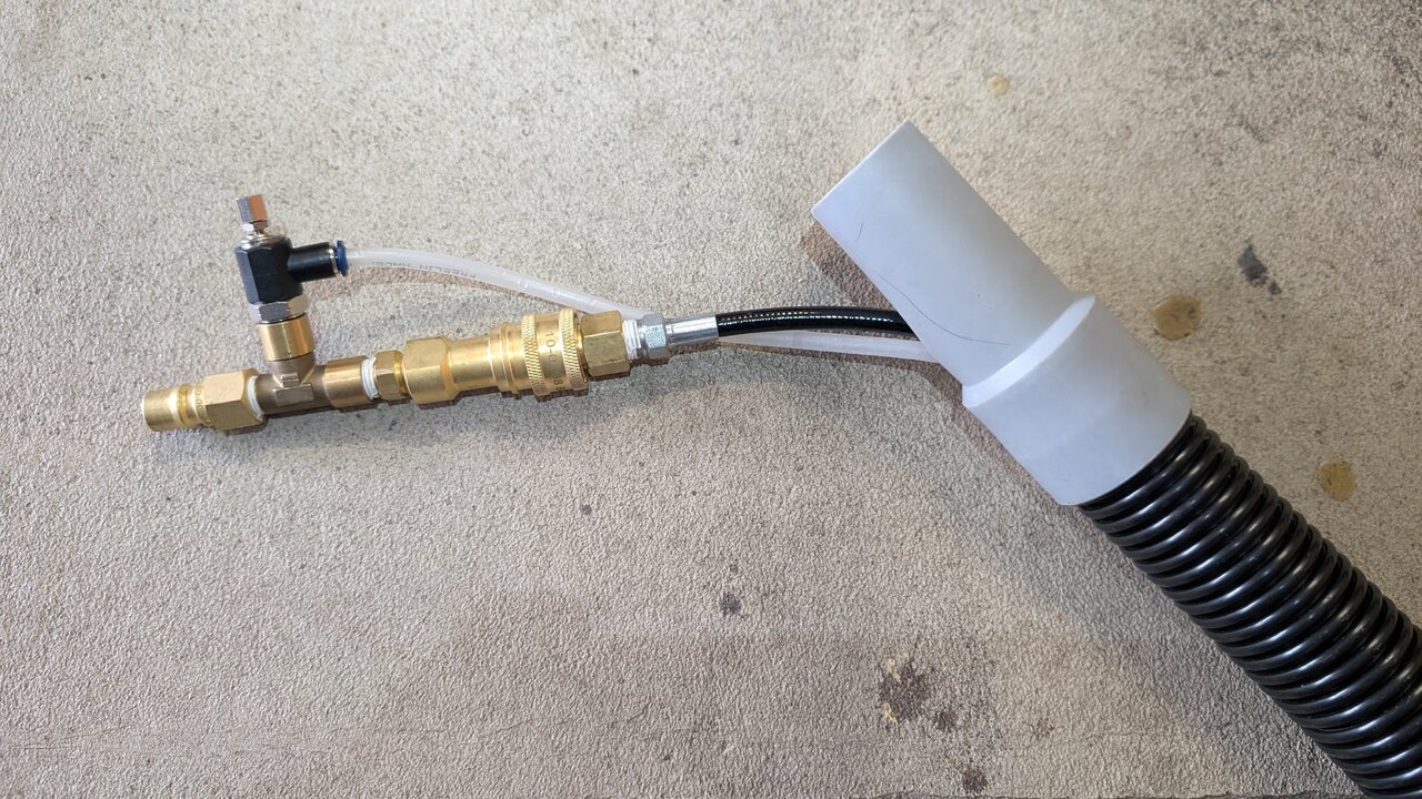

Inch and a quarter ultra flexible vac hose with swivel cuff, in 10, 15 & 20' choices.
The optional brass bypass assembly will come with a protective bag for those concerned about scratching delicate floors.
And did I mention the head will most likely be made out of titanium for a 35% weight reduction?

It all looks good so far.
Titanium should make it as light as a plastic tool, with more durability.
The bypass set up might not readily survive careless cleaners/techs, but it seems the bag should help with this. I think the feature is worth this potential issue, as you can control pressure/flow, and I would think it should enable enough flow to activate flow controlled burners.
Will that feature be an option?

That opening is about as wide as a Big Mouth Bass. Looks like it might pull fabric a little too much. Any optional cage like glide?

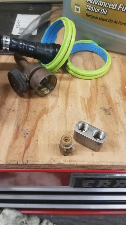

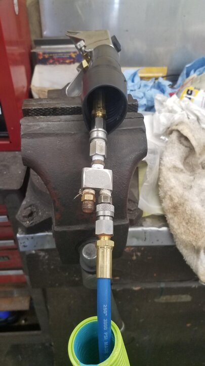

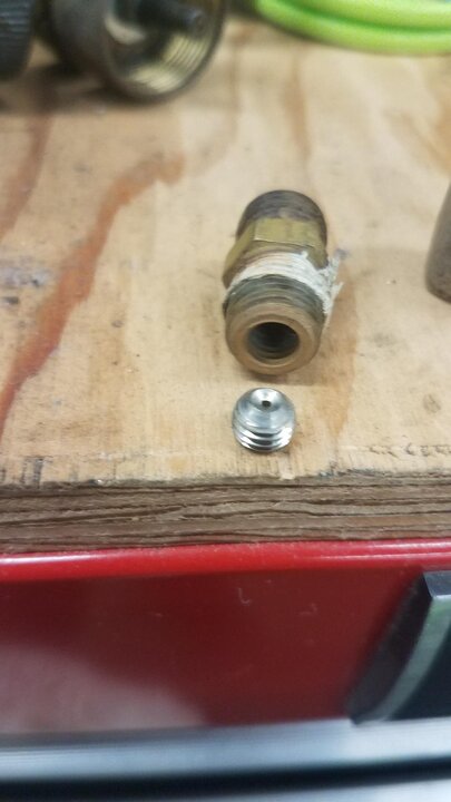

This is what i use to bypass on all my upholstery tools its built from off the shelf parts from a kleanrite solvent tool. It's simple and can be easily removed if necessary
View attachment 129914 View attachment 129915 View attachment 129916 View attachment 129917 View attachment 129918
Forgot to say , the short teflon hose is there so as the jet of hot solution doesn't cut a hole in vacuum hose(and it would). The teflon hose is connected to a small orifice used inside kleanrite solvent extractors return line
