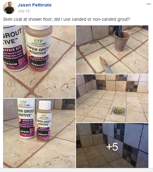

Why Florida doesn't require a license to install tile is beyond me. So does that mean any Joe off the street can simply open a tile installation business? That doesn't fly here over in California, anyone caught working without a contractor's license is fined, no warnings.
What's also interesting is how your business listing has you as "
Clean Image Of Orlando - Tile & Stone Contractor".
I would post a link but this is my 24thth post and apparently this board requires 25 before posting links. you can see the link in the pic.
8ecb7fa8-502a-4cc0-9fa2-d7303bd2a791
TCNA does require sealant for change of plane areas, I mentioned that before, scroll up and you'll see that I probably mentioned that a few times. It's no secret. Silicone happens to be one type of sealant, there are others and that information is available online to the general public via The TCNA website for those who would like more info that.
Yes, SGA has not been approved by the TCNA, nor is on our list of things to do. We, and what I mean by "We" is that the Tile/Grout restoration industry understands that those recommendations (as that is all it is, a recommendation by the TCNA) are outdated. Again, I'm not alone on this. I said it before and I'll say it again, there is a HUGE disconnect between the Tile installation industry and Tile/Grout restoration industry. The TCNA is centered around new installations which is the exact opposite of the restoration industry. Most contractors, or non contractors who install tile rarely ever see there work again. However, the restoration industry are those who actually see how these outdated methods are performing.
Why is it that I get phone calls everyday from individuals who want to know more about SGA because silicone doesn't work in wet areas. I'm talking homeowners, DIY'ers, Contractors, Non Contractors and Hotels. My Youtube channel has been a great resource for this common issue.
Now I'm sure you will have something to say about how SGA is not TCNA approved and that you live by the TCNA handbook because there's a reason why epoxy shouldn't be used at corners, but I just did that for you so no need to keep repeating this debate.
This product is not for you and that's ok, it's not for everyone so unless you plan on testing it for yourself, your wasting time commenting on why it's not for you. Cool, awesome, move on buddy.
Final note, you mentioned the John Bridge forum which raises my question. If Mr. John Bridge himself has a view on this very subject, would you second guess his professional opinion?
