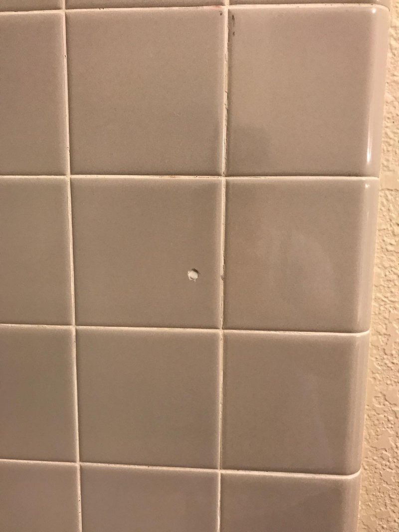

Jason my guys tried filling holes left over on a tub enclosure wall from the mollies.
They could not get your product level with the tile surface, it sort of dimple'd in..
Any tricks?
Any tricks?
@Mikey P , here’s a tip. Pack those holes first with a thick mix of grout/water as a backer, then mix Super Grout Additive® as thick as possible for the final layer. Have your guys apply more epoxy on this one.
Same idea with any repair area that have large gaps.

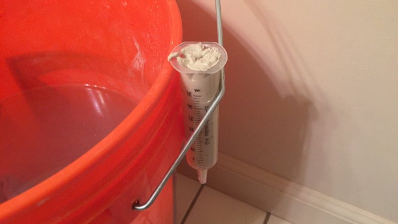

@Acp , get yourself a grout color chart and find the closest color. @Caulkmaster will mix different colors for custom matching. I always save any remaining epoxy as a sample and label them for future reference. Tip: let the remaining epoxy dry in the syringe overnight then remove it for a perfect cylinder core sample like in the pic.
You can also use the bucket to hold the syringe when filling. It frees up your hands.

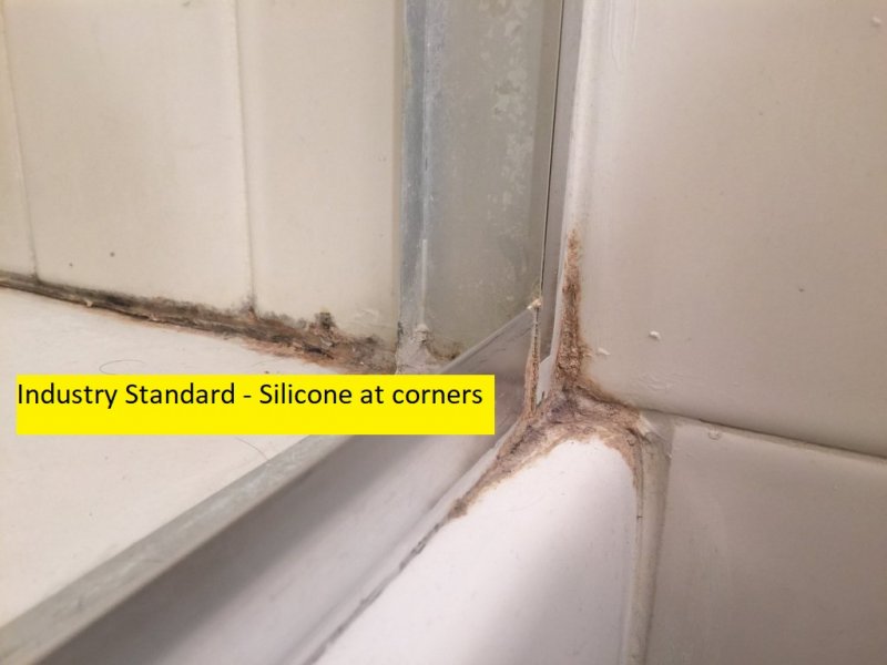

1. If you take a cement based grout, sealed or unsealed because sealing does zero for water proofing, then apply caulk around the perimeter, over a period of time the grout will draw the water under the tile and the pan becomes water logged. Yes, the caulk or silicone gets hammered from underneath and then turns black and has to be replaced.
2. It's very common for water to spit out once the caulk has been removed on a cement based grouted floor.
3. water to crawl up a wall 12"-18" and find it's way to crawl into the wall cavity has never been witnessed in my 30 years of ripping showers out. I have seen tub showers that were tiled over green board or the drywall that is designed to be used in wet areas which is a joke because it doesn't work with mastic, wick water 4' off the ground.
4. Allowing grout to vapor out is not realistic because those pans never dry out so it's a constant battle on a shower that is used on a daily basis. I've ripped out a great number of showers that had not been used in months only to see the shower floor mortar bed saturated. Those weep holes don't work either. Mineral deposits can easily clog those. The idea sounds good on paper but doesn't work in the real world.
5. Using epoxy grout on a new shower floor solves everything and eliminates shitty products like silicone and caulk.
6. Any work over a saturated shower floor needs to be disclosed to customer saying that there is trapped water/moisture before you started the job because cement based grouts absorb water no matter how you slice it. I'll go one step further and say if you apply a skim coat of epoxy over a cement grout, it's not going to trap more water. At this point, there's too much water already. All your doing is keeping more water from going under the tile. It's impossible to dry out a water logged shower floor without ripping everything out to the studs and floor.

mix any color grout for color matching.
Industry standards are outdated and have been for several years. It's a fact and the pro's that run tile/grout restoration businesses no longer have to use low quality products that typically result in call backs.
Here's what the TCNA recommends for change of plane, right out of the handbook. Industry standard but certainly not Industry wide!
