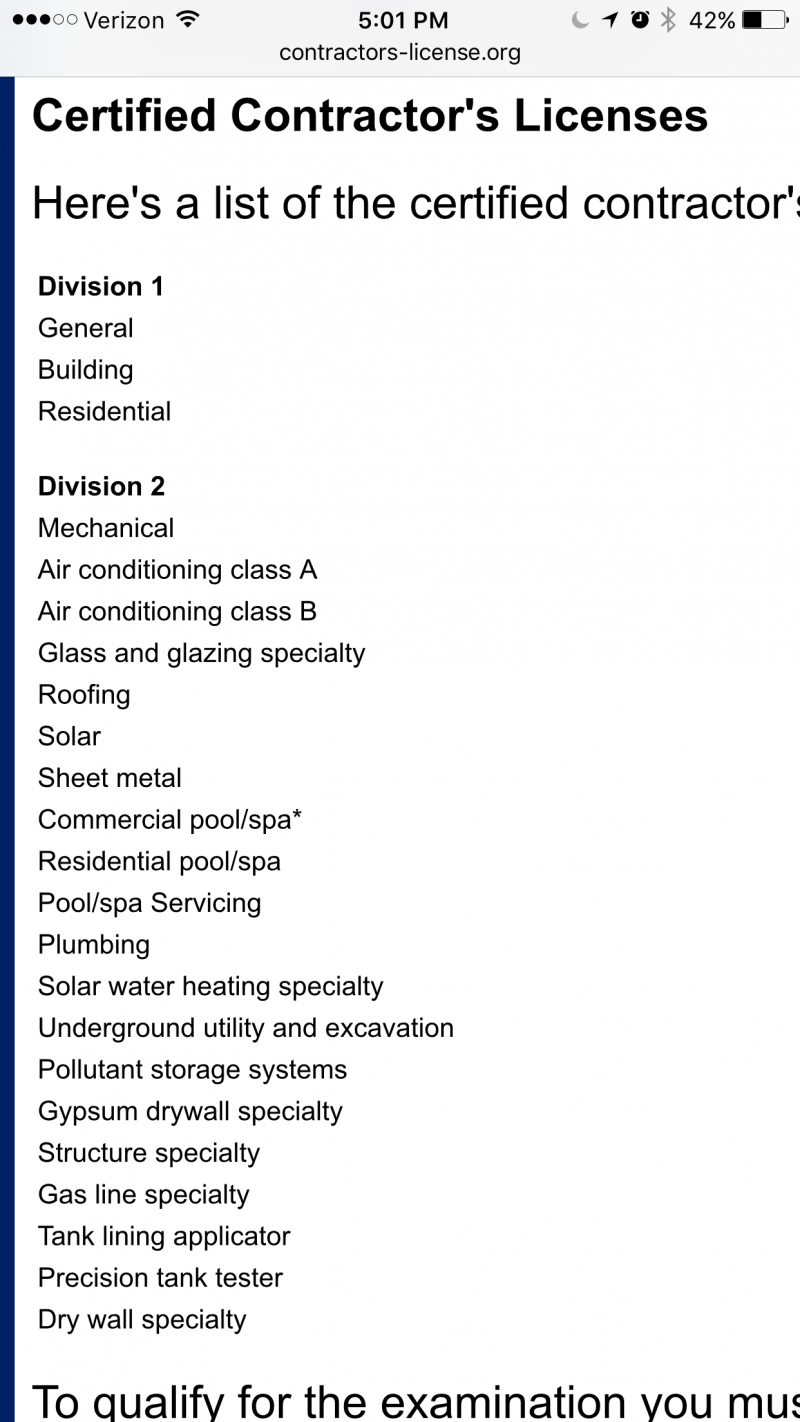

To answer your question. There is no such thing as a liscence for a tile contractor in FL.
So no.
So, TCNA recommends caulk? Your answer was vague.
So no.
Wow, ok

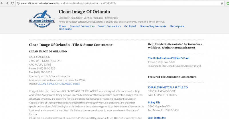

Why Florida doesn't require a license to install tile is beyond me. So does that mean any Joe off the street can simply open a tile installation business? That doesn't fly here over in California, anyone caught working without a contractor's license is fined, no warnings.
What's also interesting is how your business listing has you as "
Clean Image Of Orlando - Tile & Stone Contractor".
I would post a link but this is my 24thth post and apparently this board requires 25 before posting links. you can see the link in the pic.

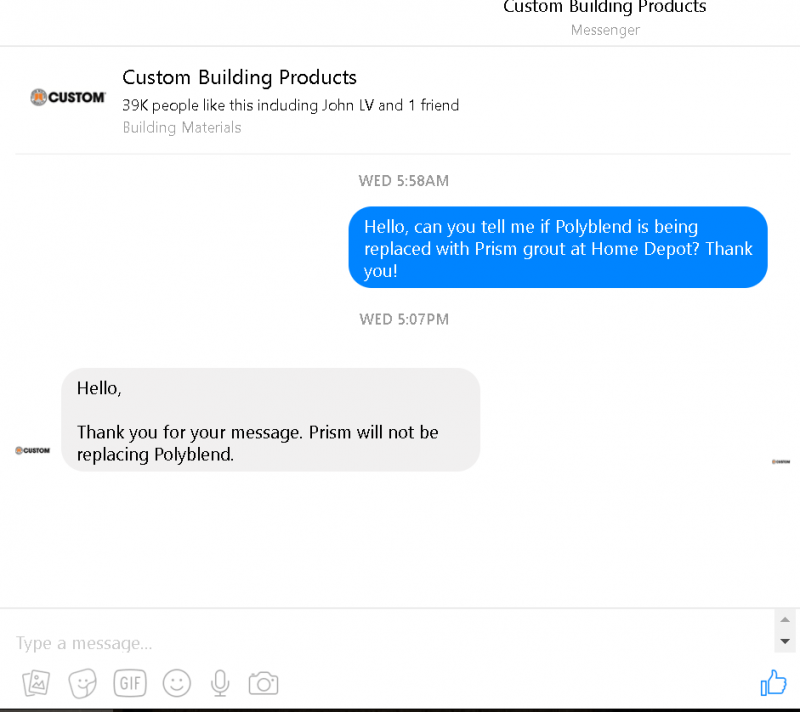

There's no intention of replacing it with Prism grout. I messaged Custom Building Product directly through facebook messenger where they confirmed what I have been saying.
